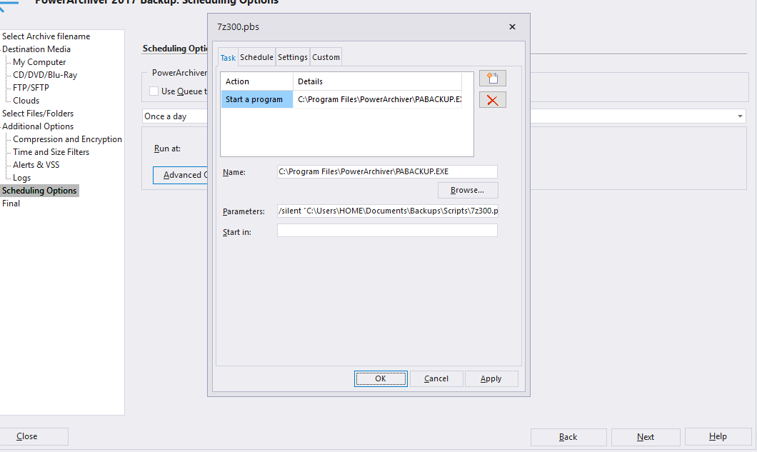

            @mili Is it possible to have a snap of the ‘advanced options’ screen overhere ? I never have seen the options, as ‘advanced’ never worked for me in any PA version
            I discussed this on ‘chat’ but finally give it up.
            Plan B : I use the MS OS build in Time Scheduler to launch my PBS scripts. But wanna compare your ‘advanced’ with the ‘advanced’ options of MS. Thanks.
              @pirrbe you sure do spend a lot of time worrying about Powerarchiver :)
              here is the screenshot

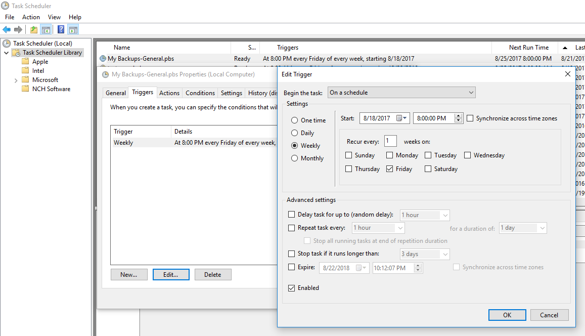

                      Thanks for the PBS. We have been attempting to reproduce it, with no luck however. The Adv. options screen starts always. Does the same occur for you when you create a new backup? or is the error message appearing only on older PBS scripts created in previous versions?
                      In regards to the scheduled time, the dropdown is a quick select menu and shows time in half hour intervals. The Adv. Options screen allows for more precise time input.
                      Also, you can do the same(more precise/advanced options) through the Task Scheduler in windows.
