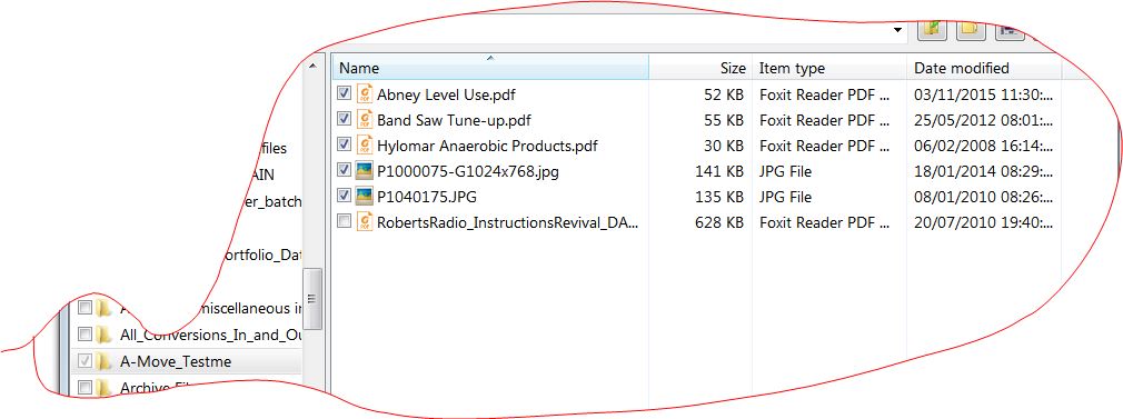

                  Test folder, 6 files.

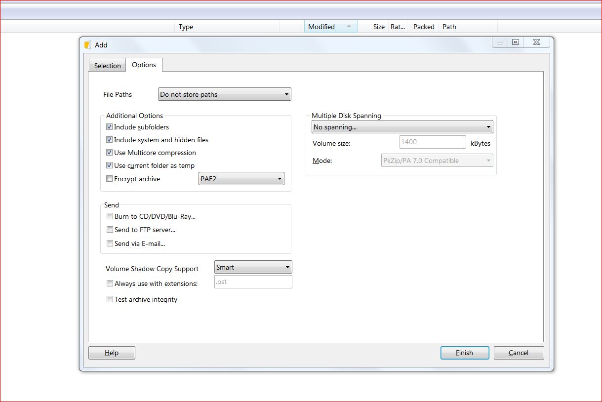

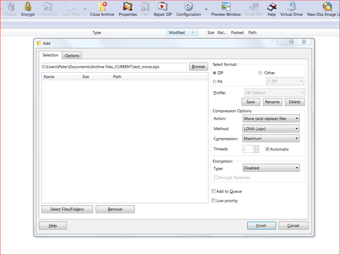

                  Move 5 files to test archive per settings in shots 1 and 2 and selection in shot 3

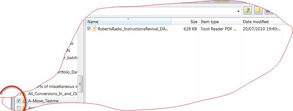

                  Folder remains with 1 file left
                  Move remaining file per next shot. Note that the folder and file boxes are bold-ticked.
                  File moves, folder disappears.
                  Only one instance of PA running.
                  If I use the “Simple” add window, I can perform exactly the same steps, but after the last file is moved, the folder remains.
                    got it, it occurs when selecting files via the Select files/folders button.
