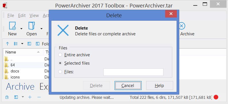

    I had a large .tar file (a backed up WSL) and I want to delete a few directories and their contents from it using PA2023. PA just destroys the whole archive as soon as I try to delete a directory, leaving it in a state where PA2023 won’t even open it any more. I tried several times and also tried compressing it to .tar.xz instead - same result. This should either actually work, or it should say operation not supported and do nothing.

      But when i select a folder and click on delete it does nothing except showing a progress bar and refreshing with files and folders intact as if nothing happened
      Serious Bug or am i expecting something which isn’t implemented?

          Thanks for the info. are you also getting the screen in the screenshot and PA just stays there?
          Is your Tar file a .tar.gz or a .tar?
          It seems like the archive is being updated once a folder inside is deleted, and given that you’re working with a large large archive, it could be taking a while to update.
          In our tests here, once a folder inside is deleted, PA takes a few seconds(or more depending on the archive size) to update the archive.
          If possible now, try deleting a folder and let PowerArchiver update the archive. It eventually should update it and return to archive(without the progress/delete dialog that is in screenshot.
          Let us know if that helped and thanks for the info!
