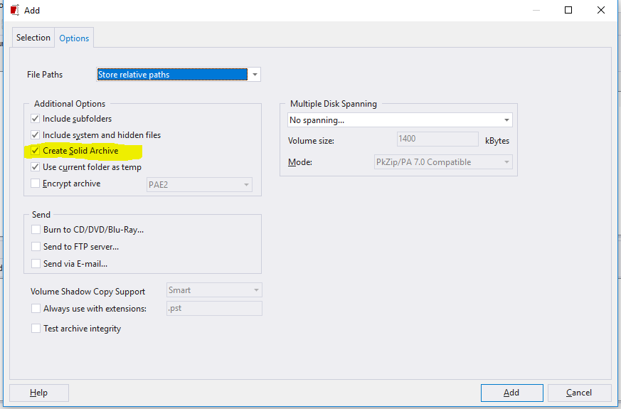

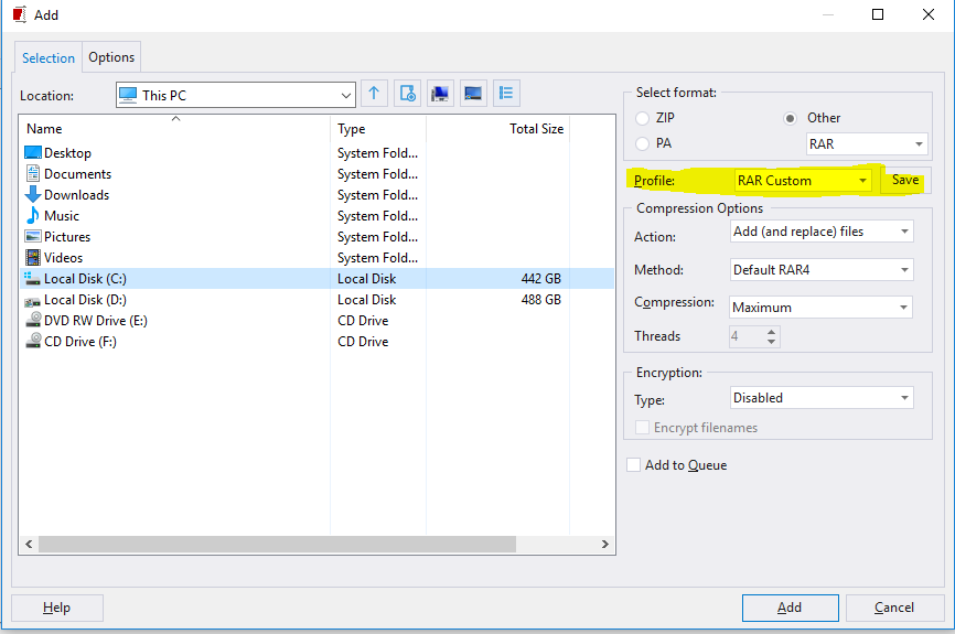

                            Hi @RobertM
                            The compression profile section in config relates to usage of formats through shell extensions.
                            You can create additional compression profiles which you can use in add dialogs such as the “New archive” add dialog and compress w options. Here is a screenshot for reference;
                            the new archive/add dialog has an Options tab at the top where additional options, such as the Solid Archive checkbox, are located. It’s there for every format and .PA format as an Additional Options tab for more settings.
                            • R Offline
                              RobertM
                              If it had been a snake it would have bit me! Thanks for pointing this out! I missed entirely the Options tab.
