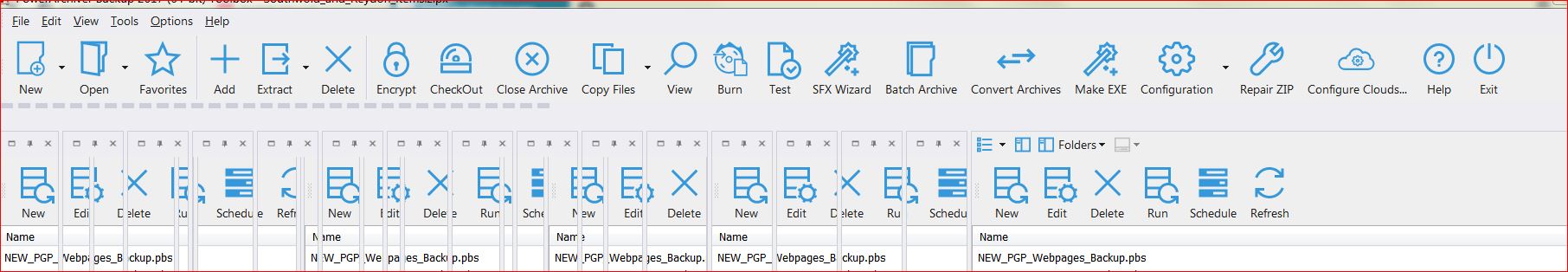

            I have just cleared all the logs on EV, so that Errors is zero. I then ran PA, looked at an archive, and then ran a pbs script, which ran to end.
            However, the end screen for the script run was as per shot #1, with icons all over the place. This is the “flickering” and distortion I have reported before.
            The EV, previously empty, now shows 15 Sharpshell errors and 1 .NET error, and all time to the running of PABACKUP.EXE.
            This may be coincidence, or not directly connected with PA, but I’m at a loss to see how running PA would provoke the Sharpshell errors, or what else could be running at the same time to do so.2_1485096972044_sharp-#3.JPG 1_1485096972044_sharp-#2.JPG 0_1485096972043_sharp-#1.JPG

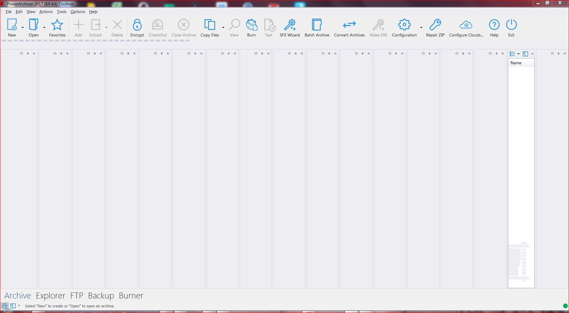

            I also have a problem where the opening screen on PA shows multiple panels, as per shot #2. If I then select an archive to open, it will appear in one of the panes - shot #3. PA is also slow to close, presumably because of the number of panes now in the screen.
            I should add that I haven’t had these Sharpshell errors before on this system (i.e. years), and they seem to have arisen since 2017 was installed. I have certainly not had the icon/screen problems with PA 2016.
            PS #3 is top shot, #2 middle, #1 bottom.

                  as to the screen issue, it is a backup bug, it doesnt have anything to do with icons in any way, it is just that backup writes wrong values in PA registry once completed and causes issues…
