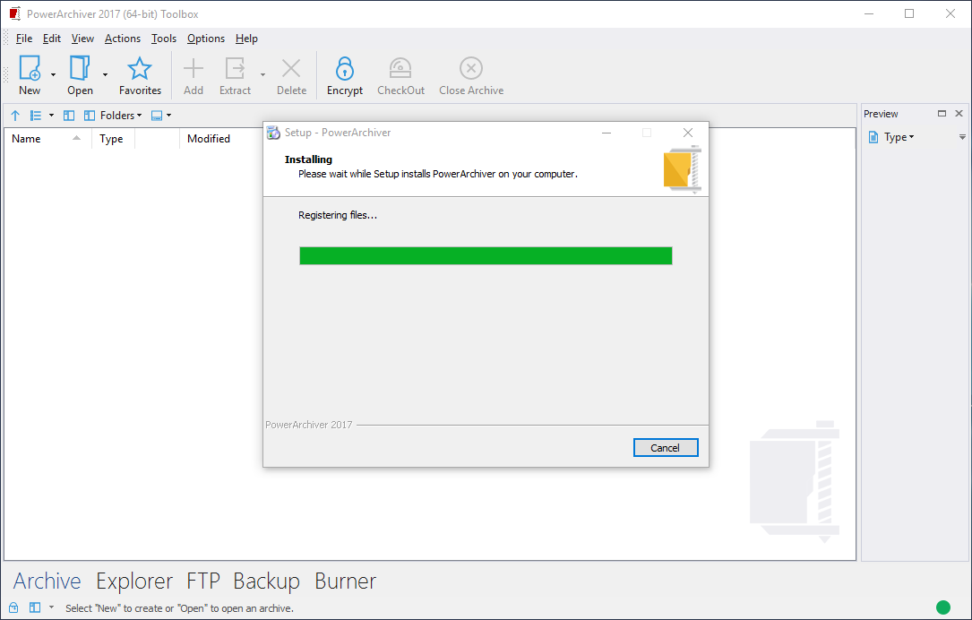

      2017 17.00.40 - Hung during install. It stuck on registering files.
      The icon had appeared on the desktop, so after a few mins I clicked that.
      PA opened ok, but the installer was still hung.
      Windows 10 *64 - Latest TP (Fast)

        @PA_Fan FYI I can make the installation finish by using Task Manager (in all users mode) to kill the offending regsvr32.exe which makes the PA setup pop up an error box which and I can then click on, if I remember correctly, “Ignore” and installation then finishes. I think the PA DLL has even been registered correctly after this, though I’m not 100% certain.

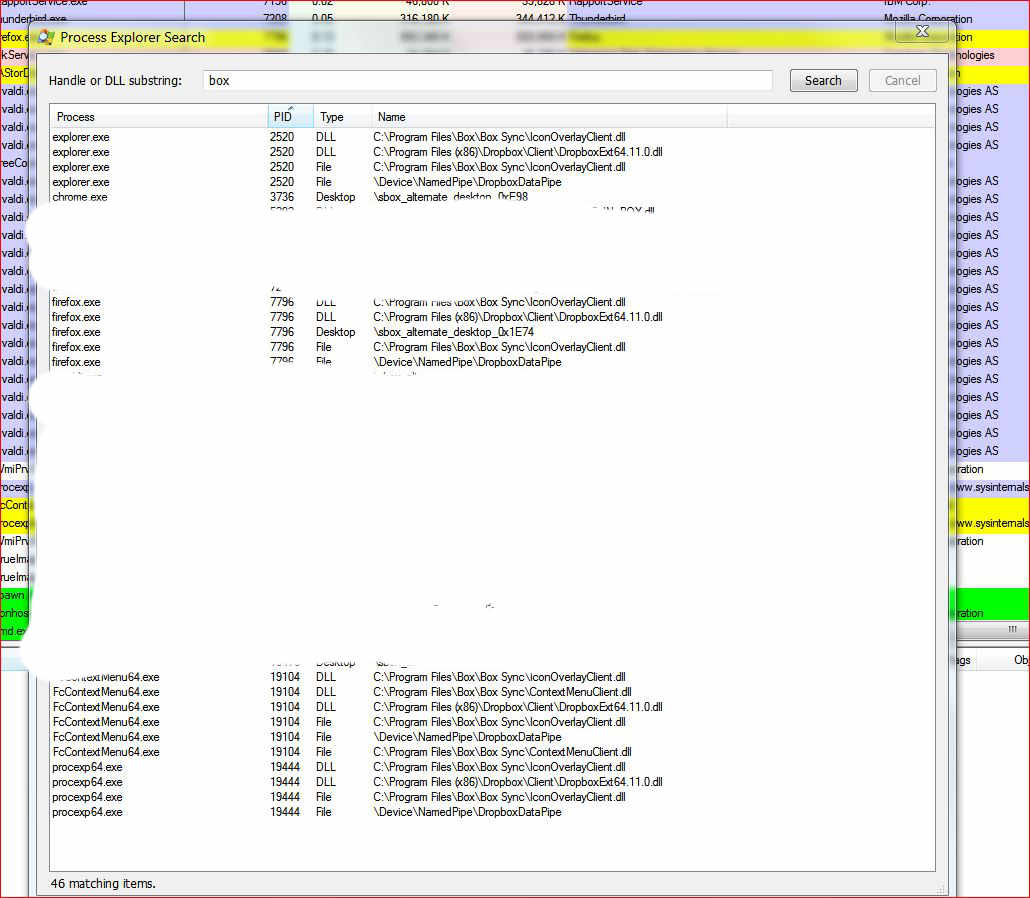

                                                              @Brian-Gregory I managed to see some of what’s happening via Process Explorer. The Box DLLs are tied into Explorer, and the Free Commander (Explorer-type and based utility) context/shell FCcontextMenu64. There’s also a tie into Firefox, which I guess must also be somehow Explorer-related.
                                                                spwolf conexware @PA_Fan
                                                                @PA_Fan i would guess thats everywhere where you right clicked and got shell menu.
                                                                You can disable their dll from loading by using shellexview
